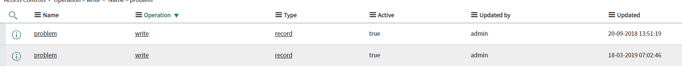

04-05-2020 09:50 AM
Hi there,
Instead of using UI Policy, have a look at these 2 out-of-the-box ACL's:
One is for the ITIL role, the other for sn_problem_write role. They both contain below code:
answer = true;
if (pm.isActive('com.snc.best_practice.problem.madrid.state_model')) {
if (current.state == ProblemState.STATES.CLOSED)
answer = false;
So if you have the plugin mentioned activated, then already the records should get read-only / no write access when a closed state is reached.
If you do not have the plugin mentioned activated, you have to edit these ACL's. You could already do this with the available condition builder. Simply adding state | is not one off | your closed states, or active | = | true.
