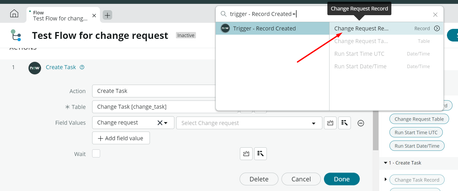

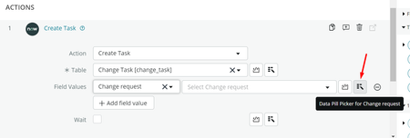

If you are using Flow designer, then it is very easy. You have to choose the correct flow action. I think create task. There is no scripting required for this. Just set the field value from the data pill picker as shown below:
After this you should be able to see your change_request field should be filled in change_task table.
