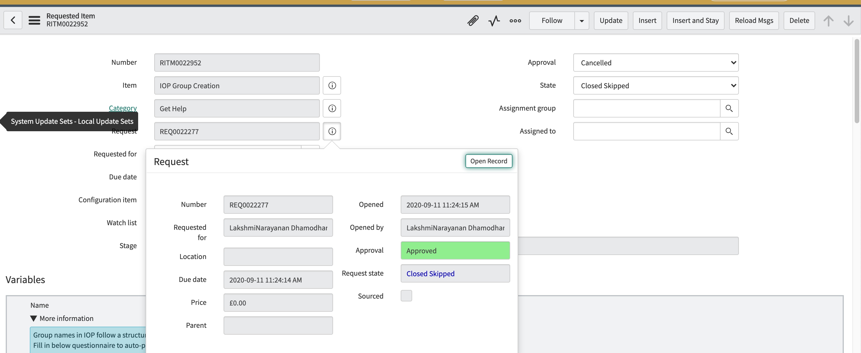

When the state field changes in RITM then, REQ state needs to be changed.
RITM States:                      REQ States :
 Open                                    Pending Approval.
 Closed Complete.                Approved, Closed Complete
 Closed Incomplete              Closed Incomplete, Closed Cancelled, Closed Rejected
 Closed Skipped                   Closed Skipped
For Approval the state changes works fine, But not for the rejection alone.

Hello Willem, Still facing the issue.
Looks like this is a prod issue as well.
Some BR is causing this. How to find that BR?
Check for business rules on the sysapproval_approver, sc_req_item and sc_request table that have been altered. Check the business rules for 'update()' in the script. And then see if any of the ones that are left after that, could be the cause.
Will I be able to avoid BR on Flow Designer while updating Request record.
