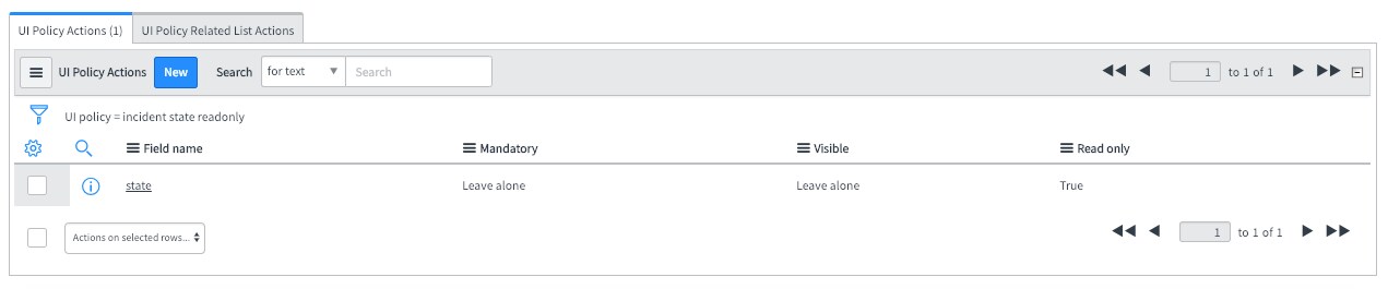

asifnoor
You can create an UI policy and UI policy action through which you can set the state field to Readonly.
Attached is the screenshot for reference.
Mark the answer as correct and helpful if this helps.
Again, still not quite what I mean.
So yes, it sets the state field as read only, but permanently sets it that way. That's what I had in the first place, then trying to add in a condition on any field that might be updated when it saves, but it doesn't work on any that I tried.
It needs to be read only ONLY for when you are creating a new incident. Once you click 'Submit', or 'Save', the field then needs to be editable.
