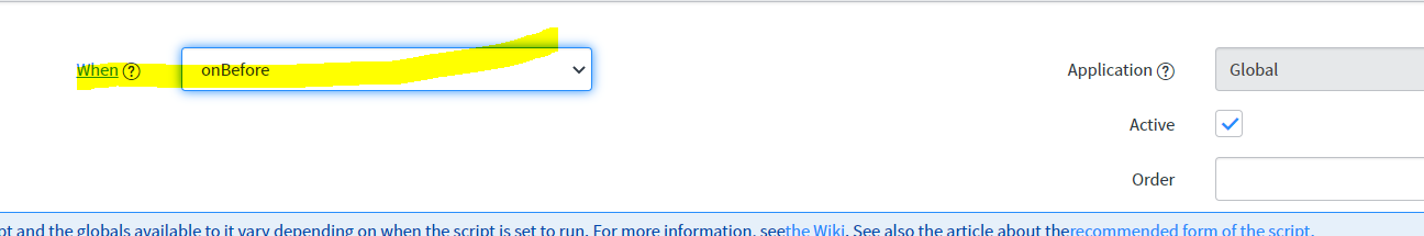

are you using onBefore script?
Joao Carlos1
Hi again Sai Kumar and Pranesh,
I tried using both but it didnt work.
I have this excel:
This is my map:
When I try to transform with this script:
(function runTransformScript(source, map, log, target /*undefined onStart*/ ) {
if (source.u_consumer.indexOf('First Name') > -1)
  target.first_name = true;
	target.update();
})(source, map, log, target);
The field first_name of the target table is not getting updated :S
Do you have any more solutions?
Thanks!
May I know are you using onBefore or onAfter transform script?
If its not onAfter() use onAfter with the above script
