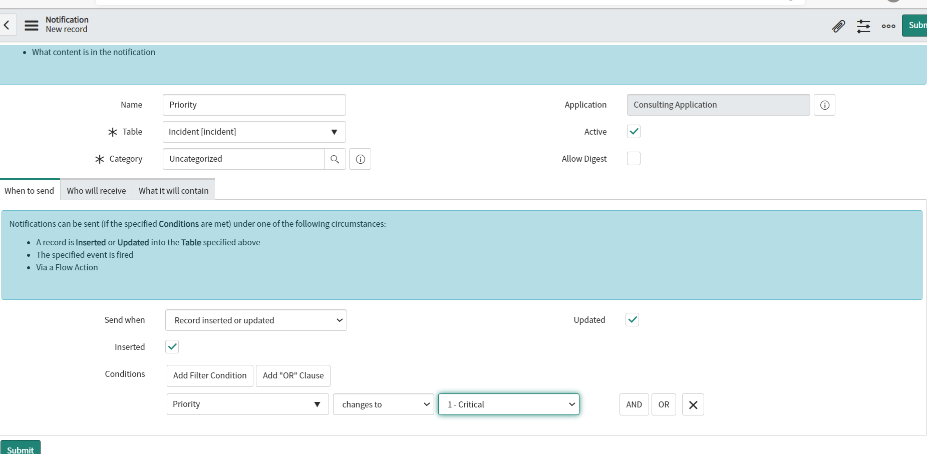

If Priority changed to P1 then need to send email to caller.

Hello @yerasumalli@gmail ,
You can create a notification for it  on incident table
1)  Create an notification on incident table and check updated check box
2) Give condition as priority changes to 1-critical
3) Go to whom to send tab and select caller as the recipient
and try to change the priority and see if the notification is triggering
Please mark my answer correct if it helps you

for sending email create record in notification(sysevent_email_action) table as shown belowfind_real_file.png
Please Mark it correct if its helpful.
