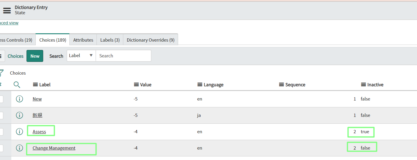

Just an off the topic question, I also created a custom label for the choice in the state field, to match my process flow formatter above, like transform Assess -> Change Management, as I test it it seems fine, but do I still need to change some scripts?
‎06-26-2022 07:31 PM
No need to change scripts. You can test and confirm. but for translations there is no script required just we need to do translations in the sys_translated table
