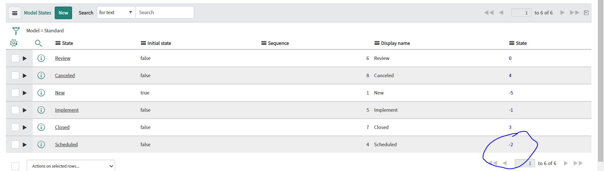

I created a new Change model that mimic the Standard change but for some reason the Scheduled button is not showing at the top on the new model i have to use the state drop down to schedule. functionally it matches the original but i would like to have that button appear like it does for the orginal.

Also on the Modal states kindly check if the state value matches correctly:-
