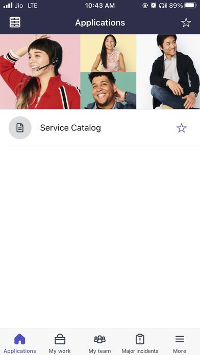

Hello Paul,
I have tried making the changes as per the instructed but still the page is not landing on my work, It is landing on application page which is attached in the screenshot below.
It will be helpful if you can provide some assistance for the same.
Thank you in advance
05-12-2023 06:10 AM
Hi Priyanka - goto sys_sg_applet_launcher.list --> search for applications and deactivate this.
05-12-2023 06:15 AM
Hello Paul,
I just checked there is no applications in the launcher screen
Priyanka
