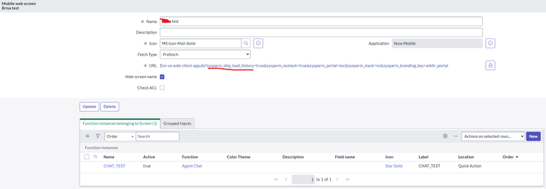

I also changed the URL to include the skip history parameter... but it is not working

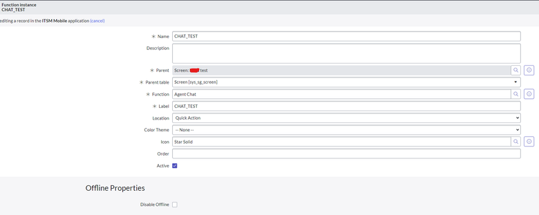

The mobile web screen record is associated to the Function Instance record

can you try to include "/" before $sn-va-web-client
like this - /$sn-va-web-client-app.do?sysparm_nostack=true&sysparm_stack=no;
‎09-22-2023 02:23 AM
Hello Paul,
Thank your for your feedback.
Unfortunately it didn't work
André

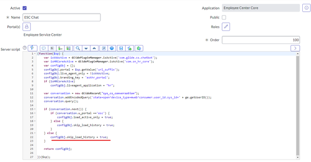

Is this the same behavior when you test in VA in the portal?
If so, try this below in the portal. if this works, try in Mobile browser, as well,
- check the Agent Chat configured for the Portal in the sp_agent_chat_config.list table and locate the portal chat
- When using this method, the VA that loads is in IFrame.
- It also has a Server Script that is used as a config.
- Modifying the script with the below config has resolved the issue:
(function($sp) {
return {
live_agent_queue: '1eb0f3631b35e91847e1eca6bd4bcbbe',
skip_load_history: true
})($sp);
Reference: https://support.servicenow.com/kb?id=kb_article_view&sysparm_article=KB1292861

We don't have the same behavior on the portal because we configured the agent chat to skip load history as you mentioned.
This is only happening on the mobile side. Just a note that if we open the mobile URL in the browser, it works well. (/$sn-va-web-client-app.do?sysparm_nostack=true&sysparm_stack=no)
