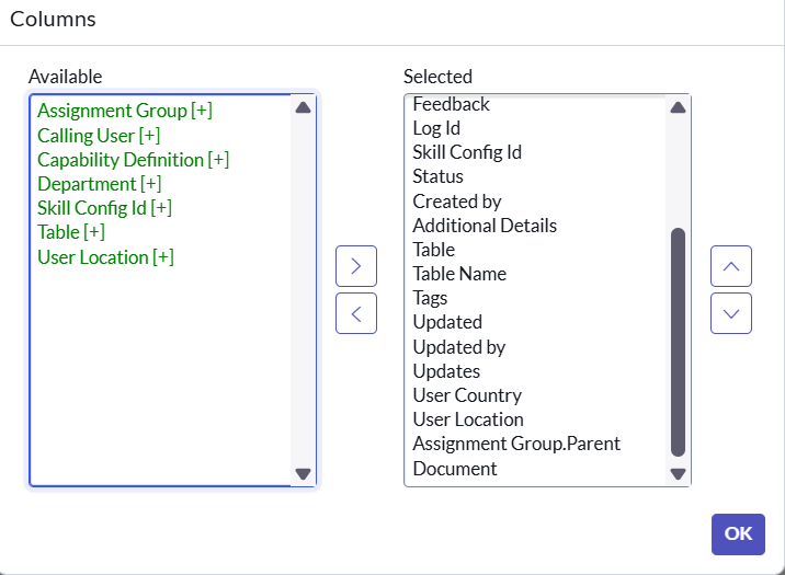

In the Now assist log metric backup table, i see that the Document field is a reference field and not a string field, But when I try to create a normal report using the Now assist log metric backup table , the Dot walking of the Document field is not visible .
Can you suggest on how to dot walk using the document field ?

anywhere in the platform you cannot dot walk a "Document ID" field type.
If you require you can create a database view of that table along with the table which is being used in Document ID field.
