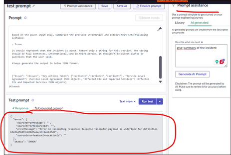

I am using ServiceNow's AI generated prompt assistance. What ever prompt it is generating, I am using the same but it throws an error.
(1) how to troubleshoot/understand why the promt is not working (strange thing is, it is SerivceNow geenrated prompt)
(2) Any tips or guidance on writing prompts for requirements?

@kaushal_snow First of all thank you so much for replying.
Now coming to the prompting, yes I understand that Prompting is a skill of writing clear and effective instructions.
But I am talking about ServiceNow inbuilt AI generated prompt assistance. So what is the point of giving that feature when it doesnt work?
I used several instructions for different scenarios and none of them work and all gives error.
And the sad part is, ServiceNow will not even show what went wrong/why that error 😕

Hi Suggy
I see - Response is expected in Given JSON Format.
(1) Is Response is coming in Plain Text - Let Say you Changed the Prompt from JSON to Plain Text
(2) I assume JSON Format is Correct . What if for Testing you Start if one Field in JSON and then Keep Adding to Know at what point error is coming?
Just a thought.
