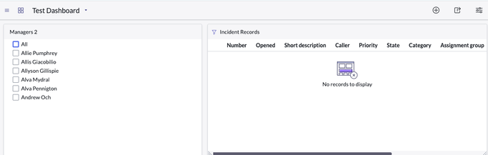

So, instead of selecting Cascading filter in the Interactive filter, select Reference as the Interactive filter and UI Type as Checkboxes.
Add the conditions you would need in the Reference Section.
And, in the Related list add the reference table and referenced field of the Reports you want to filter on.
Here, irrespective of selecting ALL, I am seeing only One Incident "Andrew Och" is in the Assigned to field of selected records. Since, I have only ticket assigned out of the selected users.
If I removed ALL, I see no records.
So, the All is restricted to only these users
