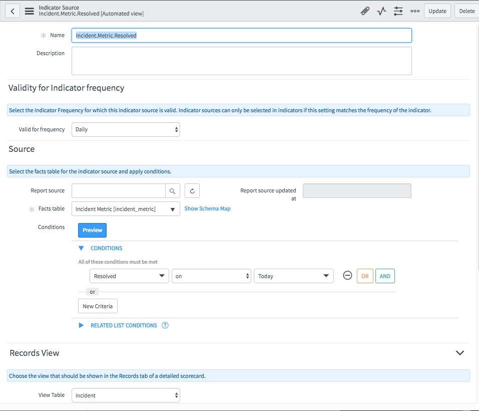

The real question is, whether this is a one-off report, or something you want to track day over day or month over month.
It's easy to do this with Performance Analytics, and that gives you access to the historical trending data, and that's where the indicator and indicator source come in - they won't impact the base reporting.   But that indicator looks like this:
and the "Incident.Metric.Resolved" indicator source looks like this:
Because of the trending/interval type nature of PA, you'll want to make sure the indicator source has some sort of date limiter, like created on Today, or Yesterday, or This month, or Last month, etc... that way you can compare date intervals.   Without that, it just becomes an aggregate of ALL records, which is of limited value and will eventually outgrow your result set.

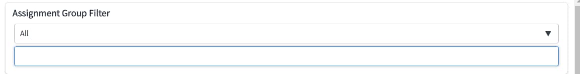

We are creating a report that will be executed a few times a month (the result is a dashboard). We created an Interactive filter and it points to the Incident_Metrics table.
We get distinct Ticket Numbers returned now which is great.
The issue: Is that the Interactive filter is a reference filter, and we cannot point to any Value field. So we are forced to reference the "Assignment group" in the Incident_Metrics table, and unfortunately that field is ALWAYS set to the current owner of the incident.
What can resolve this: What we need to do is be able to filter out the value field.
Again, maybe I'm not going in the right direction and the above will work but I wanted to give you an update.
Thanks again for your time.
brandimore
Kilo Expert
This dashboard filter above needs to be able to filter out the "value" field. Unfortunately, because it's not a reference field we cannot do this. I'm forced to pick the assignment group and as mentioned, it's ALWAYS set to the current group. Which doesn't work
