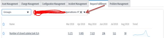

I have created a PA dashboards with multiple tabs. Each tab is different from one another.
Currently the dashboard breakdowns are outside the tabs and acting as a common filter for all tabs.
1) Is there any possibility to bring breakdown  inside each tabs. Please find below the requirements..
2) Can we have multiple selection of breakdown elements from a breakdown( Dashboard breakdown).
If anyone knows the solution please share here.
Akhil
