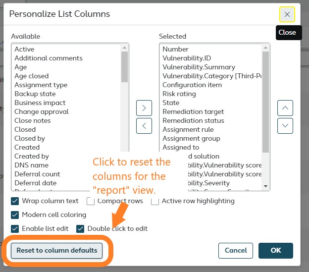

Similar to what Bill Claman described (Thanks Bill!), our particular issue occurred because we use Group By on our report.
When you group by a specific column/field, you can select the grouping (Show just this group) to view a filtered list but still within the report view. If a user adds or removes columns on this filtered list, it will impact the entire report, and they won't see any columns added or removed. They've essentially "personalized" the entire report.
To fix this, impersonate (or direct) the user to the report in question, and select one of the grouped columns. In the filtered view, personalize the list and click Reset to column defaults. They should start to see all future updates to the report after this.
Hope that helps anyone coming across this issue! See attached for some additional info.
