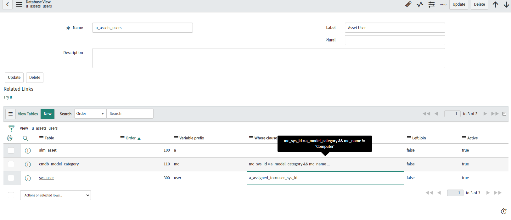

I'm attempting to join in data from 3 tables (alm_asset, cmdb_model_category, and sys_user).
Each asset is assigned to a user and each asset has a model category.
I want the dataview to pull in all asset data, but only for users that don't have a 'Computer' asset.
Additionally, I want the dataview to display one row for each user that doesn't have any assigned assets. I suspect this will need to be done with an additional Left join on the sys_user table.
Currently, the database view simply pulls in all non-'Computer' assets that are assigned to a user. But I'd like to filter out any rows which reference any user that has a 'Computer' asset.
Let me know if you could have any ideas on how to make this work or if it's even possible. Thanks
