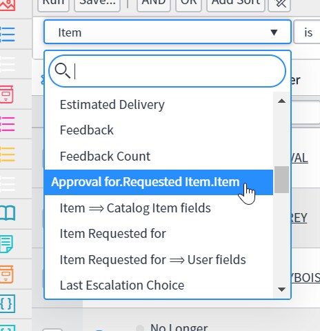

You should be able to get through approval_for and dot walk to Requested Item.Item.

So I was originally going to use a database view to connect Approver, RITMs, and Variables (sc_item_option_mtom). However, when using the view as a source it wouldn't show any of the variable fields selected on the report I was trying to generate. I just tried generating a report using your suggestion but it's the same thing 😕 for some reason dot-walking to catalog item fields will not display on the report. Any idea why this may be?
