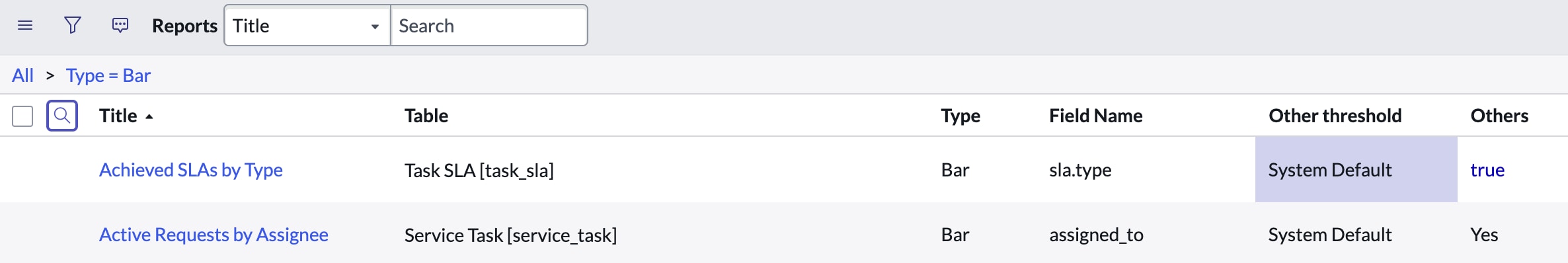

This said, you may well modify all the Bar reports via the   Reports > Admistration > All .
Filter on the Bar type and make sure you add the following 2 fields in the list:
Other threshold,  Others
Use right mouse on the titles and select Configure > List Control  in order to activate the List edit type (that is inactive OOTB).
You may then update the Other threshold and Others columns from the list.
Regards.
JP
JP
JonathanGreer
Thanks this worked.
