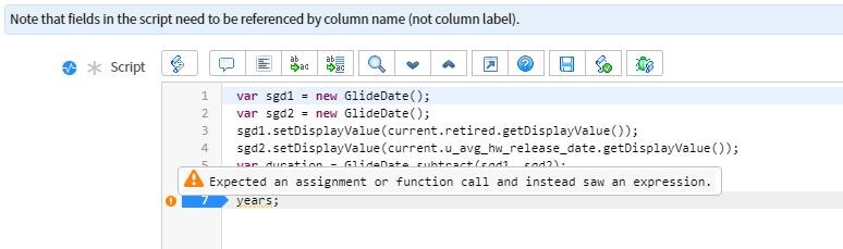

my bad, replace the line and just put "years" in it.
thilo

I tried after changing the 7th line to just
years;
and
"years";
both, but it kept showing an exclamation mark in the script screen and job fails with error.
