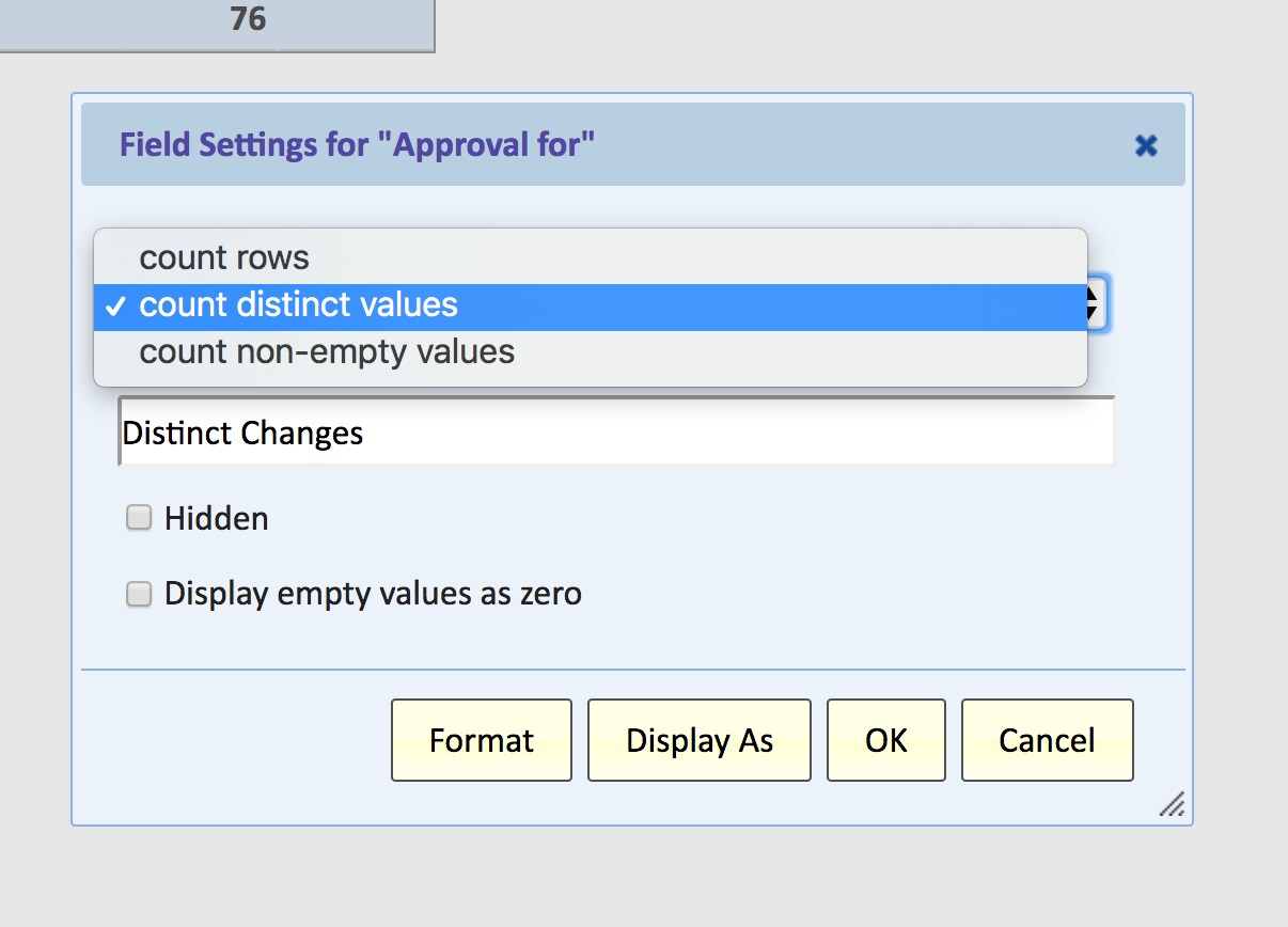

I may be misunderstanding the use case, but it seems like you're trying to count the number of change requests, not the number of approvals, correct?
If so, there is a "Count Distinct" function in the API that isn't exposed through the Reporting module. With Explore Analytics you can report on the 'distinct number of change requests':
In the example above, there are 67 approval records, but those 67 approval records are against 12 distinct changes.
