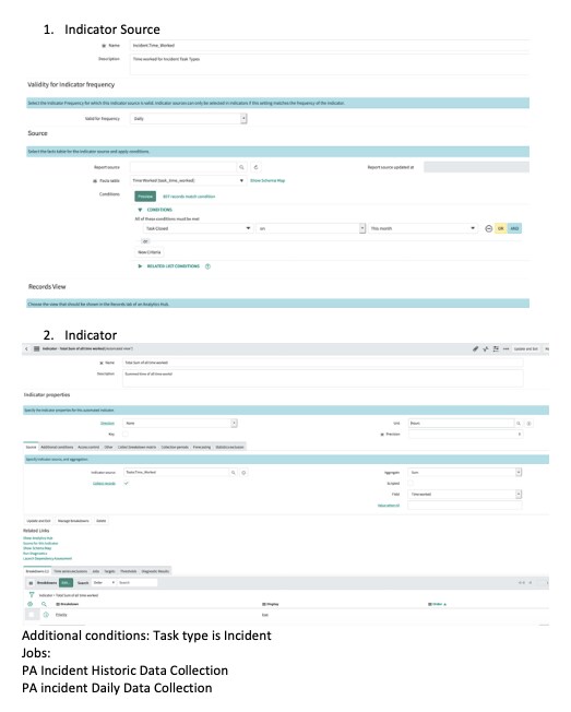

I am trying to create a widget with an Indicator that would show the time worked by incident priority. I can't seem to find how best to create this. Please can anyone help or provide a guidance?

Thanks a lot Adam,
I tried the strategy you proposed but got "No Data Available"
I have posted my steps below. I would appreciate any pointers as to what I am doing wrong.

Can you include separate screenshots?  I can't read these.  To confirm, are you using the time_worked table?

I am trying to get the time worked on Incidents from the Time Worked table (task_time_worked). The time worked is manually supplied based on the entries that fulfillers enter when they work incident tickets. The goal is to show on a month to month bases the total sum of time worked on Indents. Same will be done on Requests and Stories. If I can get one, I will replicate for the others.
I have provided the screen shots separately for readability.

I still can't read most of these, even when it blows up the image, it is still too small to read clearly.  However, a breakdown source on Sum seems very, very odd.
