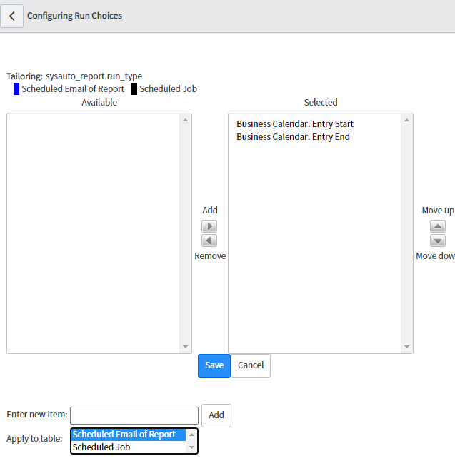

I appreciate you taking the time to respond. I've tested by allowing my account the admin role and I still cannot see any other options other than daily in the drop-down for Run when scheduling a report. (Screenshot attached for reference)

Hello, this is what I see under "Configuring Choices"
looks like they might have been deleted....
here is what I see on my screen.
If you are an admin, and you don't see the choices, then it sounds like they were deleted.
So how do you fix this?
Create the deleted choices
