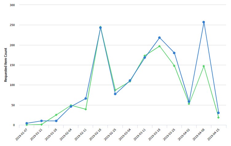

Hey there,
i have a report using a data set. The initial report was ok (i think) with 2 lines in one chart - but now the 2nd data set is missing on a TEST instance (hence the report only showing 1 of 2 lines) but i cannot get it there again by moving update sets from DEV containing that report.
I have updated the report > no luck, manually addded the report to an update set > no luck, i have made a dummy change to the data set filters - still not in captured update set??
Does anyone have an idea how i can "force" the dataset in that report to be captured in an update set again?
Thansk for any hints.
Cheers!
Martin

04-15-2019 08:02 AM
Hi Alberto,
i don`t know where that data set is actually stored at all.
It`s not showing in Reports > All. However; it looks mostly like a report.
I checked for tables which could be candidates to store this but didn`t find anything useful.
Also i didn`t see any related list in the original/parent report where i can see that data set.
Martin
04-26-2019 07:18 AM
Data sets are stored in "sys_report_layer" table.
Simply add your related record to your update set and it will be OK
