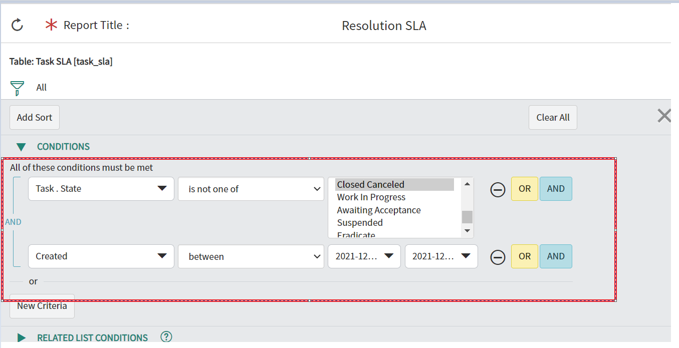

Please configure your report as shown in below screenshot to achieve what you are looking for:
Filter condition you need to dot walk in from task as Task.State is Not One Of your Canceled states you want to select
AND
Created on choose between as a Operator and then select as 1st December 2021 to 31 st December 2021
Run the report.
Shloke
Shloke

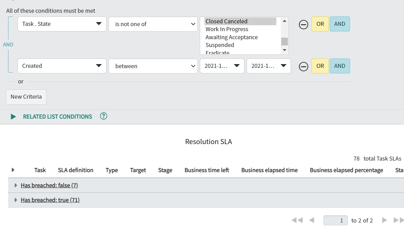

Result below:
Make sure the report is run on "task_sla" table.
Shloke
