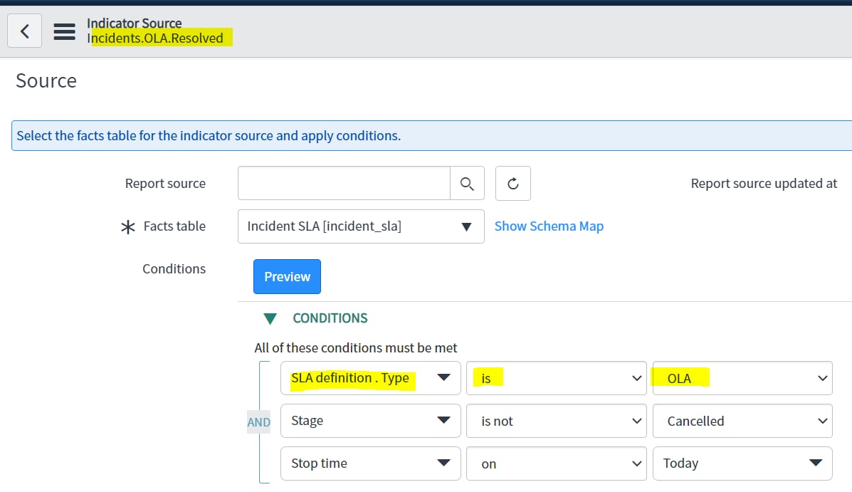

When you said: "Reason for asking this is that my understanding of some PA Indicators are using this [contract_sla.Type] =OLA to determine the Response SLA."
That's not true. If the indicator is using type OLA, then the indicator (as per your own screenshot) was for the OLA indicator, not SLA.
So everything was already separated between OLA and SLA.

  5. The indicators you mentioned are separated and one is for OLAs and one is for SLAs
  6. If either indicator is grabbing too much data (i.e., both response and resolution definitions for either OLAs or SLAs) you can tweak that

I am not sure I am following - ootb I have OLA and SLA indicator sources and matching indicators.
Could it be that the instance you are using has been modified?

The indicators are not wrong...they're just setup before you have built any OLA definitions.
So it's covering both...for when you use both....
