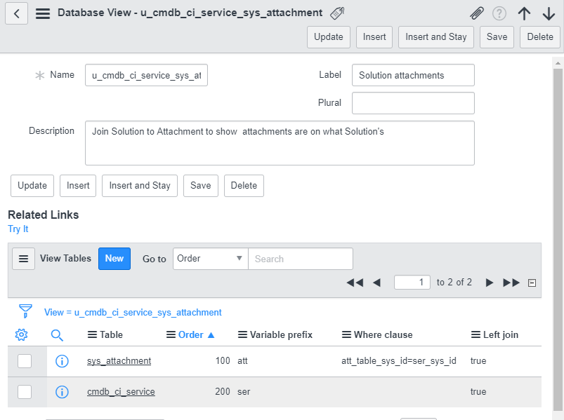

When reporting on the sys_attachment table how can i tell which record it is attached to?
RichardSaunders
I have a filter condition: table is cmdb_ci_service
But with the available column fields I can only get 'File Name' this is of any use, none of which tell me which service they are attached to.
Any help on this please?

Sorry for the late reply, thanks i have got it half working although i think i have the 'where clause' wrong?
Hi RichardSaunders,
My bad for reaching you this much late. Please set the where clause as of below screenshot and let me know:
I hope this helps.Please mark correct/helpful based on impact
I get this?
Hi Richard,
Did you try putting the Where clause as I have provided in the screenshot? I guess that the where clause is not set properly. Request you to provide the Full screenshot of the Database view.
See screenshot
