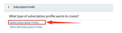

Here is some basic info on how to setup/manage your adobe subscriptions. Hope this helps to get you started.
1. Setup a subscription profile for Adobe. It's under the menu item for 'Integration - Office 365 & Adobe Cloud'
2. Scheduled job 'SAM - Import user subscriptions' will pull all subscriptions once your profile is setup.It runs weekly, but you can execute it immediately to get your subscription information pulled in from Adobe.
3. Add or import your software entitlements for Adobe subscriptions. Screen below has an example. You can define your subscription start/end date, unit cost and license metric.
For reconciliation to work, need to make sure:
Metric group = Adobe
License Metric = User Subscription
Software Product should be flagged as subscription software.
4. You can then reconcile your adobe subscriptions with the entitlements you entered. ServiceNow reconciliation engine will calculate your compliance based on Adobe licensing rules.
