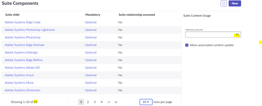

    I want to understand how suite components licenses will be consumed in ServiceNow. I have Adobe Creative Cloud All apps and there are plenty of products as child components in this but only few were installed on end users machines and mainly Acrobat was installed in many machines and there are no other suite components installed. I made four software models to be 'Mandatory' and kept the inference percentage as 75%, but when i run reconciliation machines with only Acrobat are consuming parent licenses instead of component, can anyone explain how to configure this inference percentage?

  • "CC All Apps" Software Model based on DMAP DMAP0084844, contains 33 Suite Components
Inference Percentage
  • Inference Percentage is 75% -> 25 out of 33 products must be installed to infer that "CC All Apps" is installed in this device
  • Inference Percentage is 50% -> 16 out of 33 products must be installed to infer ...
  • Inference Percentage is 25% -> 8 out of 33 products must be installed to infer ...

@MercBuilding Great information from @dreinhardt, I would note that the inference percentage requires the products to be installed. In your case, only few were installed on end users' machines and only Acrobat was mainly installed. In your example, you made four software models to be mandatory and set the inference percent to 75%. This would mean that 3 out of 4 apps should be installed on a device to count it against the Adobe Creative Cloud All apps license. Here are a few things I can think of that could help with your reconciliation:
1. Check how many Adobe apps are typically installed on a device that should utilize a Creative Cloud All apps (DMAP0084844) license. If there's only a few, I suggest you set your inference percent to a lower one e.g. 10-15%.
2. Check your discovery models per Adobe app to see which software model (parent or components) they are pointing to. You can revert normalization on specific ones that should utilize the correct software model (and entitlement).
