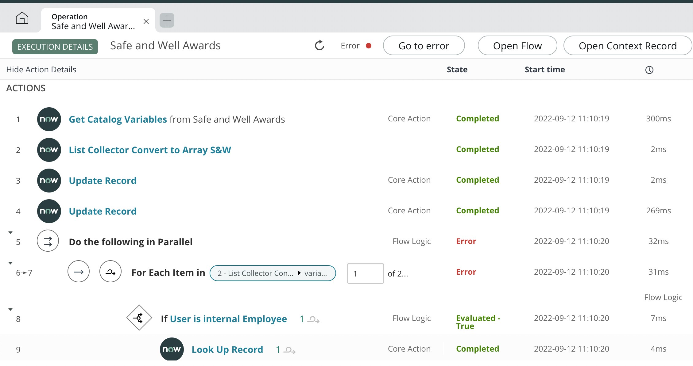

Hi i have been working on list collector iteration in flow designer. I have encountered issues in looping through every users' selected in the list collector field and looking up records for each of these names to send notification to their respective manager. Attached screenshots are what have been worked on. I believe some where along the lines 10 to 12 - there's an extra step required to dot walk to the manager's records when multiple users are selected in the 'employees' names field (a list collector type field)' so the system can look up their manager's records to receive an email. Can anyone please help?

are you not able to dot walk using data pill to manager since you are already using Lookup Record

Tricky part is the "lookup record" versus "look up records" action. Once they are differentiated, you can dot walk to the manager field without any error. Attached screenshot is how it's done.
