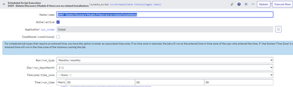

please execute the following scheduled job to remove all discovery models without a software installation.
By default the jobs is executed monthly and this could be reason why you seen discovery models without installation data.
Navigate to > System Scheduler > Scheduled Jobs > Scheduled Jobs > "SAM - Delete Discovery Models if there are no related Installations"
