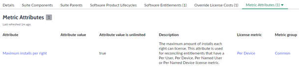

Hi @MarlonD20,
the definition is based on the "Metric Attributes" provided by the PPN or added manually to a software model, when this is created without an entitlement/PPN as source. Software model fields (servicenow.com)
In this example, which is based on a entitlement with Common/Per Device metric, it doesn't matter how many installations of this software model found per device it will still count as 1 entitlement. If you adjust the "Attribut value", e.g., to 2 it will count for each pair of installation per device one entitlement. Well the "Per Device" isn't a good example - think about "Per User" - when the user is assigned to 3 devices and the value is set to "2", the consumption for this user is "2 active use rights"
Fast way to get an overview about the amount of installations is to create the required software models, run the scheduled job "SAM - Get install count for software model" and add the column "Install count" to the software model view.
Best, Dennis
