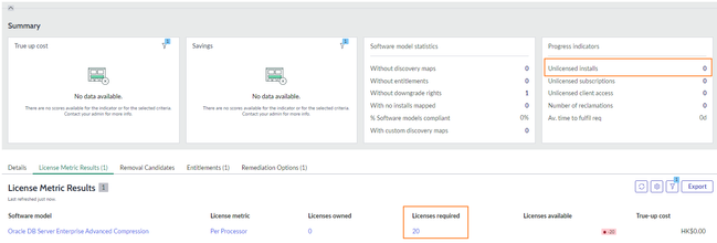

hi @alexpanzare , you mentioned that the software installation will be marked as "unlicensed install" if it is tied to an entitlement that doesn't have enough license to cover it. Therefore, where will the installation be located, in SAM workspace, if I have "0" license owned with some license usage? Will the usage be put under "Licenses Required" or under the "Unlicensed Installs" in the Progress indicator?
