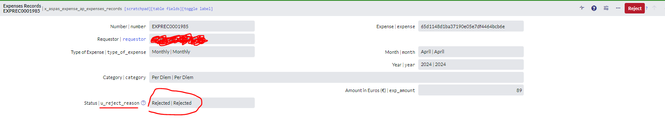

I am trying to configure UI action so that when "reject" button is clicked the status (u_reject_reason field) changes from "Requested" to "Rejected" however I am not able to save this change.
when i go back to see the record details it s back to "requested" state:
