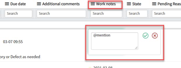

With regards to using @mentions, my team has a request to allow ITIL/platform users to add an '@mention' in work notes from a list view (i.e. right-click on the work note field).
The current issue they are facing is you can enter the '@mention' however, the 'You have been mentioned' notification doesn't send.   Appears the system is treating the '@mention' as simple text.
Is it possible to enable the @mention picklist when using list_editor on the work notes field?

If your Work Notes field is an HTML field perhaps that is a clue. Go to the AT Mention in a work note and click <> to see HTML  then as a fun hack try putting that html in list view and see what happens.

...even if the work notes are HTML, I doubt that would work regardless.
a list edit action is a feature from SN in the UI16 interface (perhaps it is carried through in workspace, haven't tried it yet) and I really doubt that little textbox would enable rich features like posting @ mentions (from a platform architecture perspective, as this happens while you are typing usually...not after commit).
I would STONGLY recommend against committing to modifying OOTB platform functionality like this for your business needs and instead rethink the business need.
