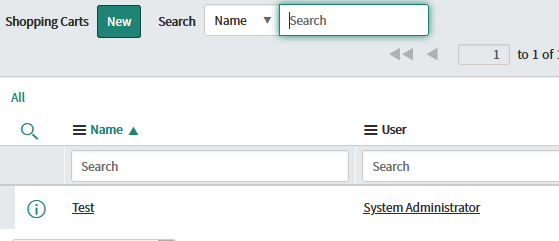

I see your "test" cart still visible, was this after checkout?
I've tried clearing all my DEFAULT carts, do you know if there's a difference between a cart with the name DEFAULT and an actual DEFAULT cart created when the cart name passed into the API is nil?
08-03-2020 12:18 PM
Oh sorry, I commented out the checkout to show you I had the test cart. If I do the checkout it is not showing.
If you do not specify a name it will use the Default. For me it just updates my current default (I again commented out the checkout):
If I remove the default cart and create test:
Can you see if the user on the cart is the same?
