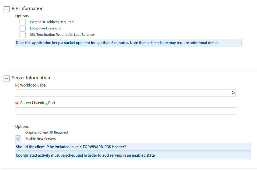

Hi Cindy.   Thanks for the input.   I'm on Geneva as well.   Here is what it looked like when I first added the field messages:
The messages for "Long-Lived Session" and "Original (Client) IP Required" are not directly under their checkboxes.   Then I added the labels as you recommended, and it looked like this:
This is much better, but for it to work I had to put a label before each one, and that seemed a bit redundant. I decided to dive back into the rendered HTML, and I finally figured out that I was specifying the wrong element name when manually adding the title.   The following does work for checkboxes in an onLoad client script:
gel('ni.IO:<sysid>_label').title = 'some value';
Originally I was leaving off the "_label" portion of the element name, but when I added that it works perfectly.

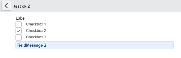

I generally use field messages rather than tool tips - especially for checkboxes.
I gave this a try, and it puts it at the bottom of the whole "Options" section it creates for my group of checkboxes.   I suppose I could make that work if it didn't stick the "Options" title above each set of checkboxes.   Do you have any insights into how that might be accomplished?
ckube
can you put up a screenshot?   and what version of ServiceNow you are on?   I am on Geneva and as long as I use a Label variable before my checkboxes it doesn't do that.
