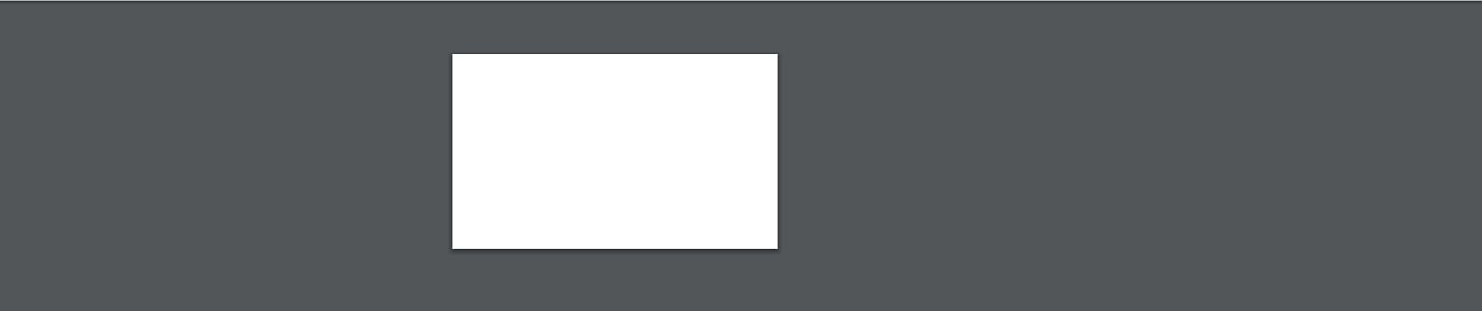

Hi again! I have been successful in creating widgets that hold the images on the catalog form inside the Service Portal. I have also been able to create a PDF with "blank" images and attach it to a record. The only problem I am having now is to get the image from the widget to be added to the PDF. Does anyone have some experience/knowledge on how to do this?

This is the PDF that gets attached. I am unsure if the image was put in this document and then a blank one overwrote it or if it never put the image in this document. I provided the HTML code and client code in the button widget. The images are on the page but in a different widget. I think my code grabs the image, but I am having trouble getting the image to the PDF. Hopefully someone here on the community can assist me in what I might be missing?
