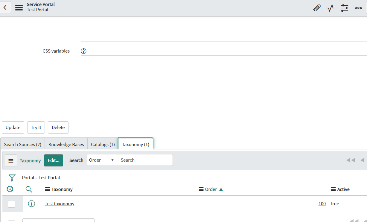

Created a taxonomy and added it to the portal but its not showing in portal
Rahul62
I have created a new taxonomy and added it to the portal. But it is not reflecting in the portal .

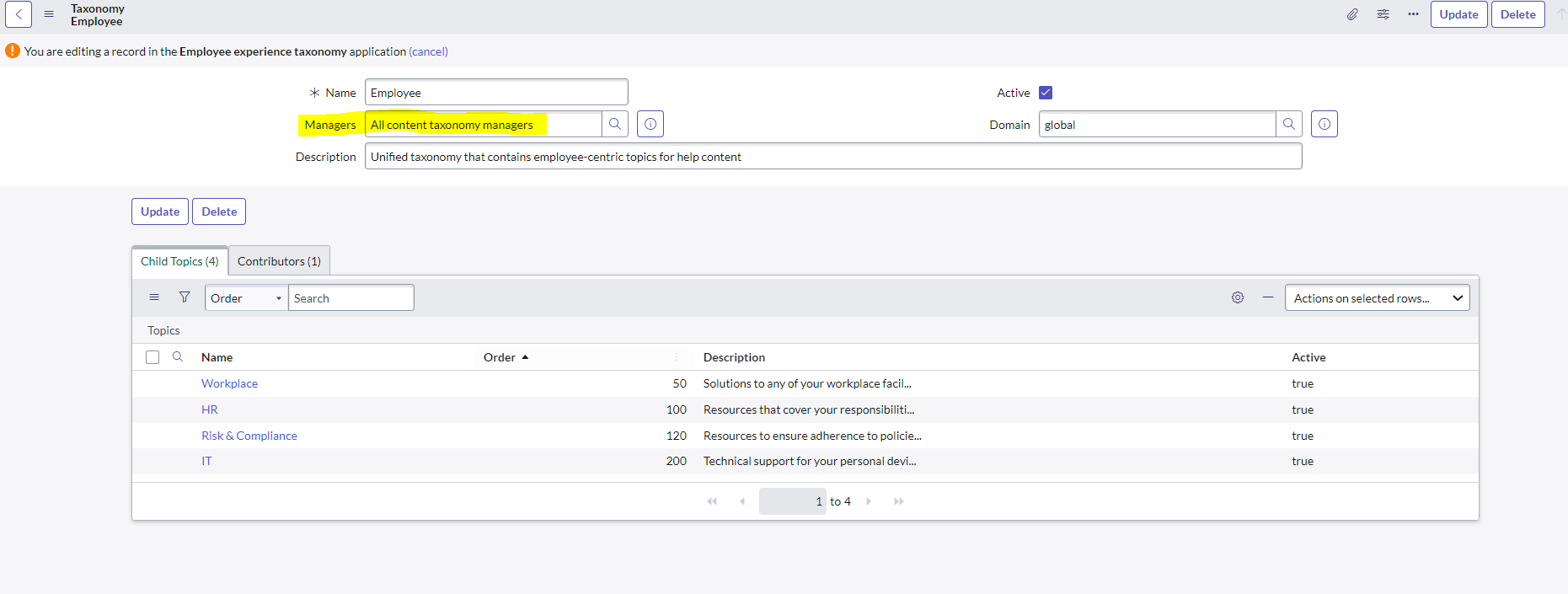

You need to add at least one connected content to your newly-created child topics to be able to see them in the portal.
Hi Rahul,
You need to give the "Managers" !! If you don't have one create one and add the roles, who should see this Taxonomy using the Managers field.
