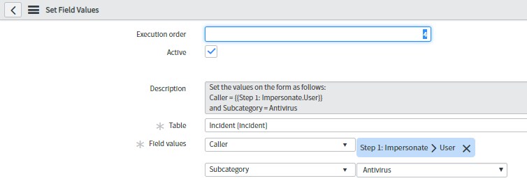

In working with the Automated Test Framework, if I add a test step to set values using a data pill, it's stored in the inputs.field_values (no problem). As an example, the data pill appears in the record as...
While if I examine the gliderecord looking at the inputs.field_values in a background script, I see this as..
caller_id={{step['84d4d851db2d6700407f78eebf9619e6'].user}}^subcategory=antivirus^EQ
In other words, what's visible in the GUI is reflected in the record (which is all good)...
