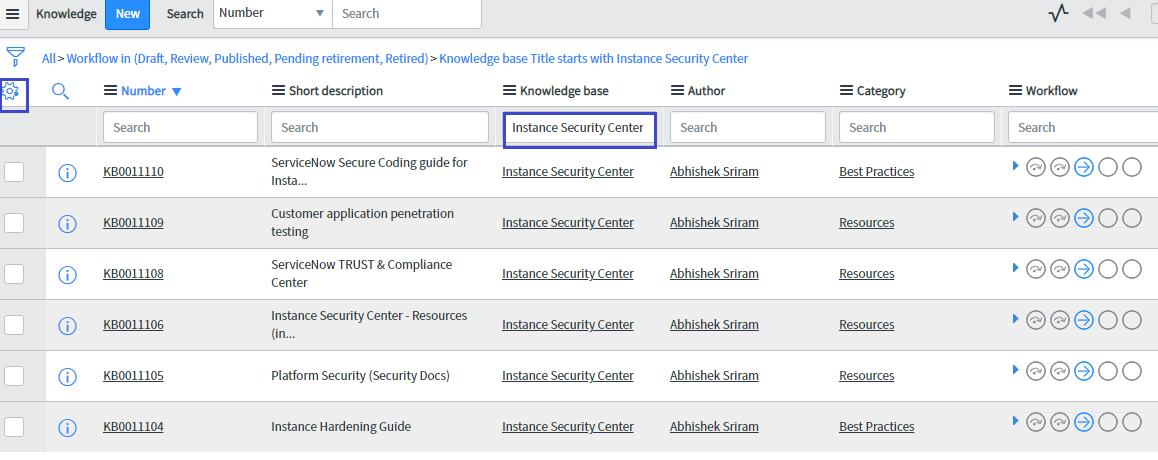

Hi Cory,
Please navigate to the Knowledge articles table.
kb_knowledge_list

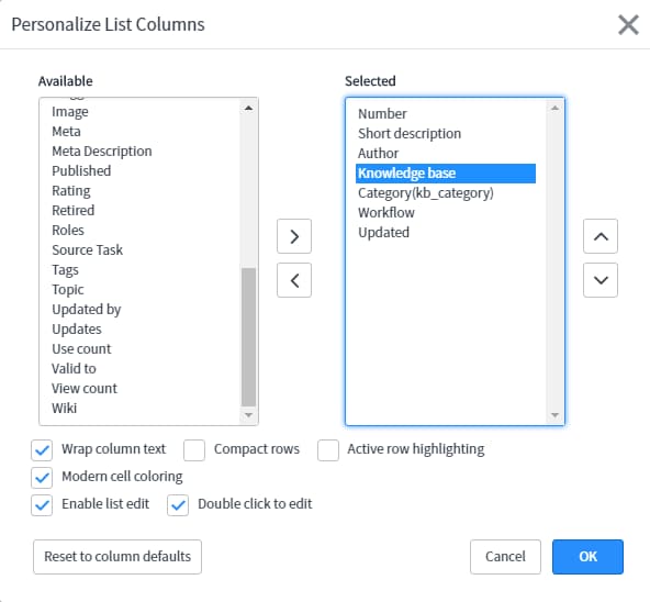

1. Using the gear icon, add the column "Knowledge Base" to the table by moving it to the right.
2. Filter the knowledge base by searching for the knowledge base you want to export as shown below:
3. You can now export in the any of the ServiceNow listed formats.

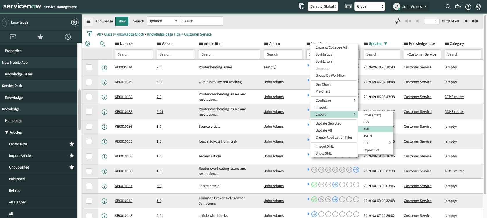

09-12-2019 01:32 PM
How is the export to XML option not showing up for you?
Did you look at the articles in list view, right-click any column header, then choose Export > XML?
Secondly, can't you just clone your Prod instance back to Test or would be doing that sometime soon (near future) anyway? Could they not wait until then?

09-12-2019 10:24 PM
Hi Cory,
You won't get an export option from the related list.
You need to go to Knowledge -> Articles -> All from the left navigation. On that list you can filter on the Knowledge Base = "End User". I have given an example below with Knowledge base "Customer Service". You will see the export to XML option on this list.
09-13-2019 07:39 AM
Hi Lokenath,
Your response was absolutely correct, thanks very much for taking the time to respond. The xml file is monstrous in size but totally works.
