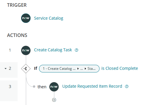

I would avoid setting it up like this.
The main Flow (which is triggered by the Service Catalog) should handle what happens with the RITM and tasks that are created by it. Simple example below.
Is there some specific reason why you are not handling it within that flow?
J_ T_
I am not doing it this way because the Task is immediately evaluated and always returns False as the State is Open when it is created so the Request and Request Item are never closed.  The Workflow does not wait for a change in the Catalog Task.  Am I missing something about your example?
