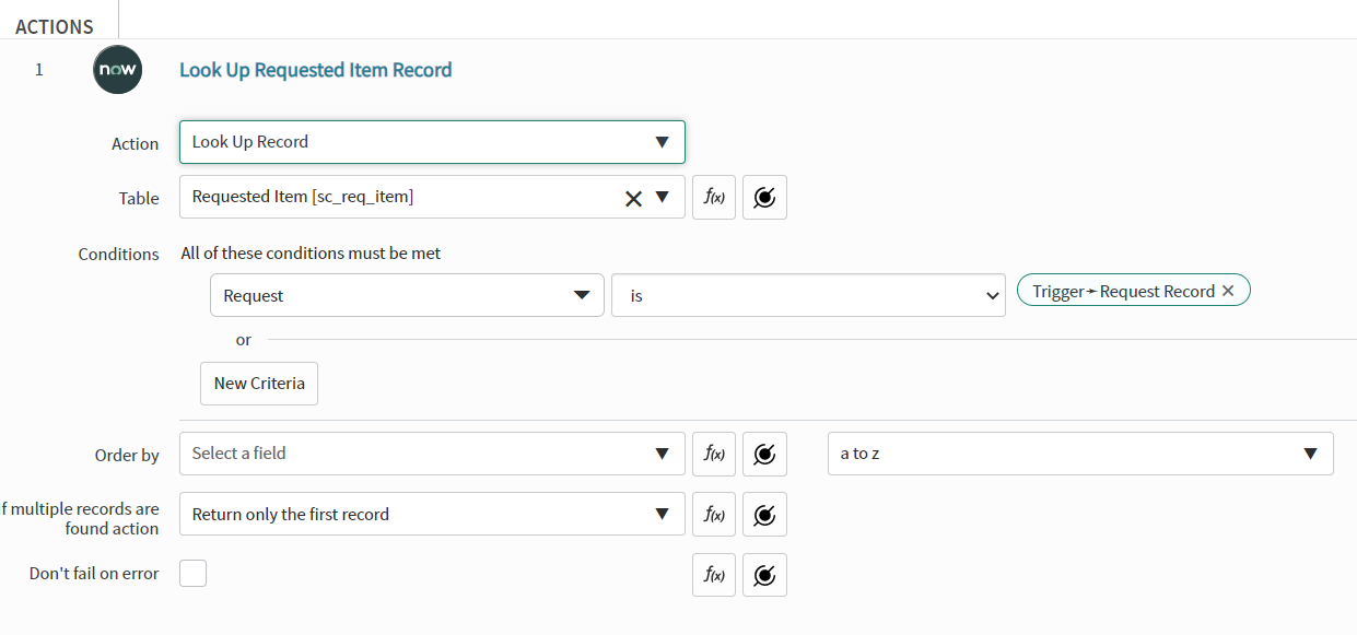

‎02-21-2022 02:02 AM
Create a flow and trigger on sc_request table instead.
I had a similar requirement. Will share the steps how I achieved by triggering on sc_request table
‎02-21-2022 02:07 AM
‎02-21-2022 02:10 AM
You dont even need to attach this flow to the catalog item.
We usually attach workflow to the catalog item in process engine
