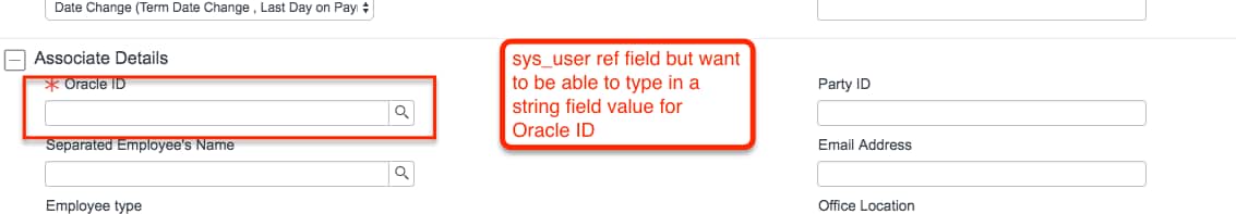

Hey Chuck,
So the ref field on the form points to sys_user and instead of looking up by Name, they want to look up the user record by the Oracle ID, which is a string field. The documentation tells how to do this if it's another reference field, like Department.
Thanks!
Cal

Doing great Michael! Always super hot here in NC.
Feel like the royal treatment today you and ctomasi responding in like 2 seconds of each other!
Thanks guys, going to try this now!
