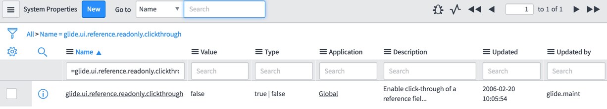

Chuck Tomasi
You may find this helpful. It includes information about how to make the reference icon appear for read-only fields using the property glide.ui.reference.readonly.clickthrough by setting it to a true value. By default, it is false.
Customizing the Reference Icon - ServiceNow Wiki
Use the menu navigation filter and type sys_properties.list, then filter for this property (as shown below.) Update the record, and you're all set.
