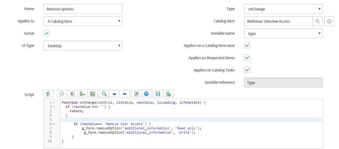

Is there   a script that can be place to remove options under a variable.   UI Policy will just hide the variable and that's not what I want.
For example:
If Remove User Access is selected for Type:
I want only N/A to show and not the other 2 options for Ready Only or Write.

That was my assumption based on the fact that you posted this in the Service Catalog space on the community and were referencing variables rather than fields.
So where in this script would I put the variable Type and Read Only and Write?
  if (newValue === '') {
      return;
          if (g_form.getValue('type') == 'Remove User Access')) {
                  g_form.removeOption('additional_information', 'Read only');
                    g_form.removeOption('additional_information', 'Write');
Your onChange client script would be set to watch the "Type" field.
That being said, this could be simplified slightly be doing this:
      return;
          if (newValue== 'Remove User Access')) {
newValue represents the choice changing select on the Type field to be "Remove User Access". If that is true, then the next two lines remove the Read only and Write options from the Additional information choice list.
This is what i have and it didn't work.
