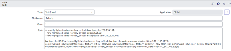

Hi @Nico12 ,
Yes, you can configure the style:
Please navigate to below link and adjust your style value accordingly :
https://your_instance_name.service-now.com/sys_ui_style.do?sys_id=a660ca267f00000101a21389acc8474a
I hope this solves your issue
Mark this as Helpful / Accept the Solution if this clears your issue
Thanks & Regards,
Ratnakar
Hi Ratnakar,
Same as Anders, this did'nt worked. I still have the dots.

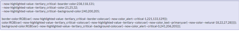

Hi @Ratnakar7 ,
Just tested your solution, but unfortunately it didn't work:
--now-highlighted-value--tertiary_critical--boarder-color:238,118,131;
--now-highlighted-value--tertiary_critical--color:21,25,32;
--now-highlighted-value--tertiary_critical--background-color:240,200,205;
border-color:RGB(var(--now-highlighted-value--tertiary_critical--border-color,var(--now-color_alert--critical-1,221,133,129)));
color:RGB(var(--now-highlighted-value--tertiary_critical--color,var(--now-highlighted-value--tertiary--color,var(--now-color_text--primary,var(--now-color--netural-18,22,27,28)))));
background-color:RGB(var(--now-highlighted-value--tertiary_critical--background-color,var(--now-color_alert--critical-0,241,206,205)));
The result:
Any other suggestions?
