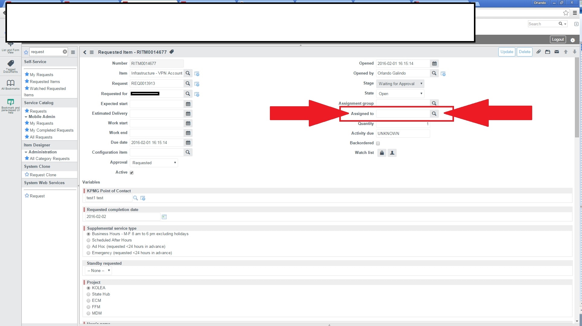

So what I want to do is for the manager field of a request, I would like that manager that is filled out in that field to be the RITM is assigned to for approval:
I have supplied the following screen shots below:
Here is the Request form:
Here is the name of the manager field:
Here is where I want to populate the "Assigned to" field to what was populated in the managers field from the request form:

You want to set the RITM "Assigned To" field to the manager variable on the form.
What you are trying in workflow is to trigger an approval for manager using approval group activity. First, for user approval (manager is user), you should use "Approaval user" activity and not "approval group". Second, if you want "assigned to" field on RITM to be same as manager variable, then you should do it via run script activity avaiable in the workflow.
Add the run script activity in your workflow at the appropriate place where you want assigned to field to be populated. Once done write down below line in script section which will set assigned to field to the manager variable on the form
current.assigned_to = current.variables.manager // I assume manager is the name of your variable.
