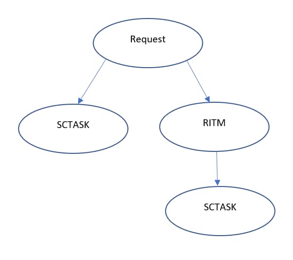

Here is an example of what I am talking about
As you can see when a REQ is created and approved, a RITM and SCTASK is also created. Within the RITM there is an additional SCTASK created. There is redundancy happening here. The users are working within the SCTASK being created on the REQ and not the RITM. If the SCTASK within the RITM is closed, it works as expected by closing the RITM and the REQ but not when the SCTASK in the REQ is closed.

@Ankur Bawiskar This is a quick visualization of what I am talking about:
The solution you gave me closes the REQ, but there is still an open RITM and SCTASK that is being generated through another workflow that also needs to be handled.
