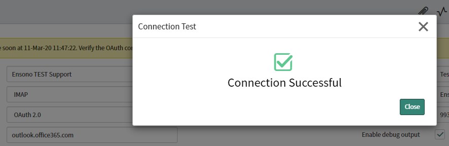

03-11-2020 12:17 AM
The only scope you need is IMAP.AccessAsUser.All (in Azure Exchange group of consents under IMAP, not Mail)
Token received will have all consents assigned to Azure application.
If you get proper scopes in your token, you have first success.
When you get proper token you should successfully test Email Account
I am currently working with Support to find out why tokens are not stored properly in Service-Now. The successful check I got only when I generate token with PostMan and paste them into SN "token received".
But generally it may work.
